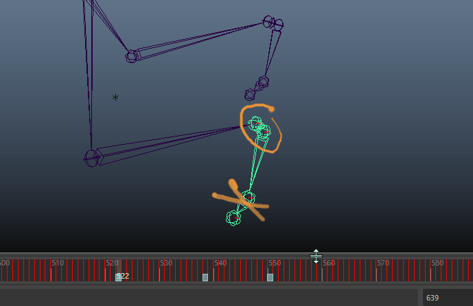

Always shows Blue Pencil frames on the Time Slider.
Selection/Context Active only shows Blue Pencil frames on the Time Slider when using Blue Pencil.
Off Hide Blue Pencil frames on the Time Slider.
