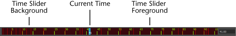

Key Ticks are red (by default) marks in the Time Slider that represent the keyframes you set for the selected object. When keys are selected, they appear white while highlighted blue (see Selecting keys on the Time Slider for an example). Breakdown keys are a special type of key displayed as green marks in the Time Slider.

Key thickness is measured in pixels. The minimum key thickness is 1 pixel and the maximum is 63 pixels.

All the curve’s keyframes in the Time Slider are now the Curve Color you selected.

The keyframes you selected and set the -tds flag for are now drawn with Time Slider Tick Special color in the Time Slider.
