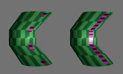

| Snap | Snaps the geometry to the driver and therefore behaves like some aspects of the ShrinkWrap deformer. It is also useful for debugging as it clearly depicts which parts of a driver are bound by the target. |

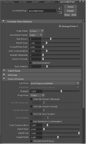

ProximityWrap1 tab in the Attribute Editor

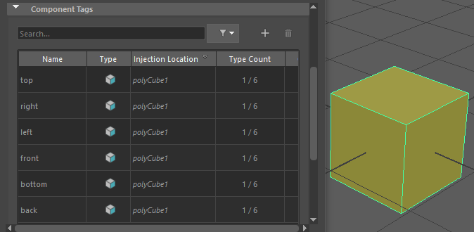

Use Bind Tags to fix unexpected vertex assignments
The default Component Tags of polyCube1.
