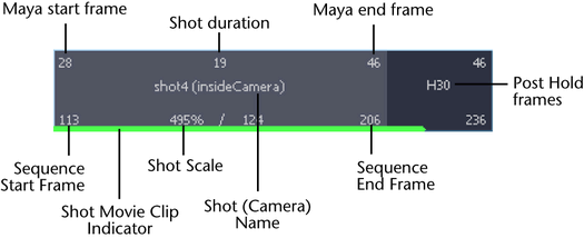

For more information on each attribute that displays on the camera shot, see Camera shot attributes.
