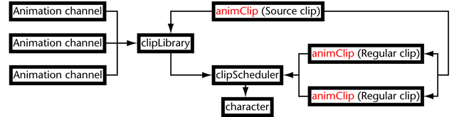

When you create a clip, the animated channels for the character are disconnected from the node or object and are then connected to a node instead. The clip library node manages and keeps track of all the source clips for the character. The clip library and all the regular clips for the character connect to the node. The clip scheduler manages and keeps track of all the regular clips for a character.
In the dependency graph, source clips and their instances (regular clips) are represented by various nodes.
