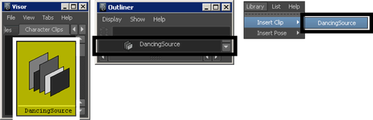

You can find source clips in the Visor, Outliner, and Library.

You can access your source clips from the Visor, Outliner, or the Library menu in Trax. See What are the Visor, Outliner, and Clip Library?. You can edit source clips by modifying their attributes in the Channel Box. See Edit source clips.
