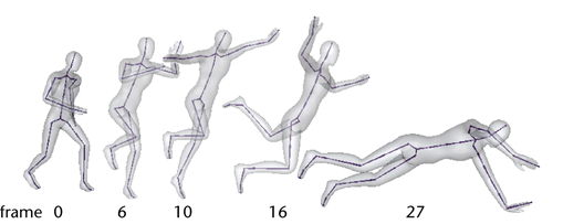

This example describes a scene with motion capture data plotted to a biped skeleton.

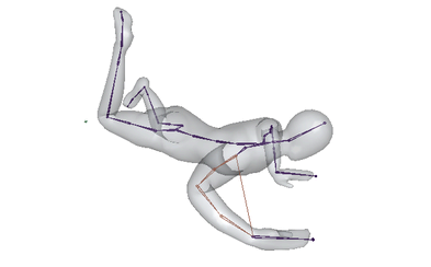

In this example animation, the wrist makes contact with the floor at frame 27, but the position of the hand is shaky and unnatural. We want the hand to hit the floor at frame 27, then stay steadily planted between frame 27 and 40. You can modify the animation between those frames to stabilize the hand as it makes contact with the floor.

After frame 27, the hand is now stabilized as it comes in contact with the floor.
