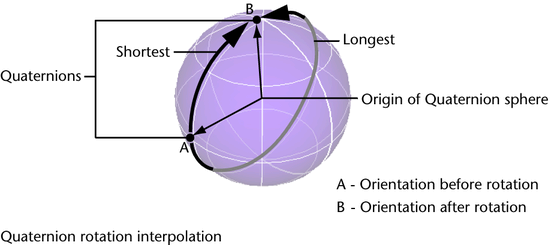

Quaternions provide smooth interpolation of animated rotations and always produce the most efficient path between keyframes in comparison to Euler angles. Quaternions store the overall orientation of an object rather than a series of individual rotations. This means that a single Quaternion stores the same amount of rotation data as three Euler angles. Since Quaternions store only orientation values, they can be used to calculate the shortest rotation from one orientation to another.

When blending animation clips in the Maya®Trax™Editor, you can select one of the following types of Quaternion rotation interpolation: Quaternion Shortest or Quaternion Longest. Quaternion Shortest interpolation uses Quaternion interpolation to find the shortest path between rotations from one clip to the next. Quaternion Longest interpolation uses Quaternion interpolation to find the longest path between rotations from one clip to the next. This path is in the opposite direction of Quaternion Shortest.
