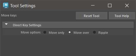

Double-click the Move Nearest Picked Key Tool icon to open the Tool Settings window.
Set one of the following options:
Disables the Move Nearest Picked Key tool’s ability to sweep throughout a curve’s keys (see Move Over, below).
The default setting lets the tool sweep through an active curve along the curve’s keys. This expedites the fine-tuning of animation curves.
When on (default), single-click editing works only on selected curves. When off, you can single-click to edit all curves. Disable this option if you want to allow single-click manipulation for all curves.
