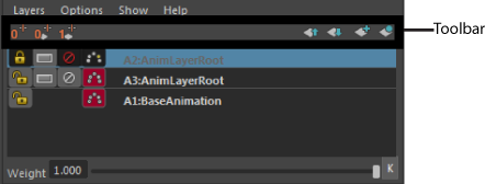

The following table describes the buttons found in the Animation Layer Editor toolbar.
Zero Key Layer |
Sets a key on the animation layer with zero offset from the original animation. This can help you demarcate a specific time range you want to edit on a layer. See "Setting Zero keys" in Keyframe objects on animation layers. |
Set Weight to 0/Set Key |
Sets and keyframes the animation layer Weight at zero. See Keyframe the weight of animation layers. |
Set Weight to 1/Set Key |
Sets and keyframes the layer Weight at 1. See Keyframe the weight of animation layers. |
Move Layer Up |
Moves the selected layer(s) up in the Animation layer pane. See Re-order animation layers. |
Move Layer Down |
Moves the selected layer(s) down in the Animation layer pane. See Re-order animation layers. |
Create Empty Layer |
See "Create Empty Layer" in Animation Layer Editor menu bar |
Create Layer From Selected |
See "Create Layer from Selected" in Animation Layer Editor menu bar. |
