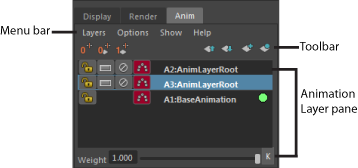

To access the Animation Layer Editor:
The Animation Layer Editor contains the menu bar, toolbar, and animation layer pane.
