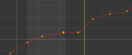

In the
Graph Editor and the
Dope Sheet Editor use the
Scale Keys Tool to scale a region of animation curve segments and the positions of keys in the graph view.
Note: You can change the
size of keys appearing in the Graph Editor Graph view with the
Key Size option in the
Graph Editor section of the
Animation (Settings) Preferences.
In the
Scale Tool Settings window, there are two ways to scale keys in the graph view.
For more information, see
Scale keys and
Scale curves.
Type
Set one of the following options:
- Manipulator
Scaling
Graph Editor keys using the
Manipulator
Scaling
Dope Sheet Editor keys using the
Manipulator
- Lets you scale keys with a manipulator box style.
- Drag-select keys and then click and drag a corner of the manipulator box.
Note: Graph Editor only: The manipulator box shows percentages to let you precisely gauge how much you are affecting the selected keys. You can also double-click the value to enter a custom value.
- Gestural
Scaling
Gestural Type
Scaling
Gestural Type
- Changes the way keys are scaled in the graph view so the mouse position, rather than a scaling box, determines the scaling vectors.
- Middle-click and drag left or right in the Graph View/View area.
Only scale selected keys
When on, the
Scale Keys Tool affects only selected keys. When off,
Scale Keys Tool affects all keys.
Note: When the
Only scale selected keys option is off, keys are scaled in a ripple mode.
