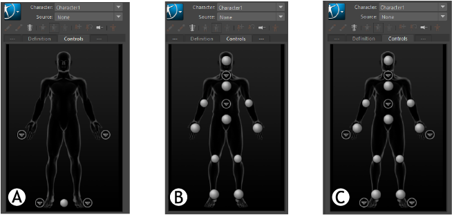

The three Character Controls templates that are installed with Maya
