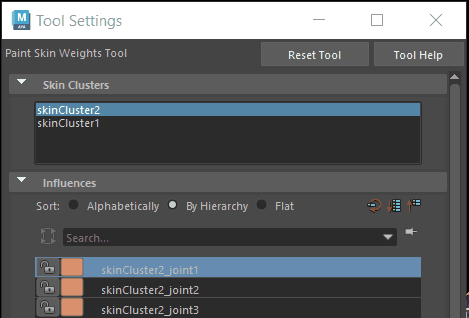

The Skin Cluster area lets you control individual skin clusters on geometry that has more than one skin cluster applied. If you select a skin cluster in the Skin Clusters list, the Influence section also updates with data about the selected skin cluster.

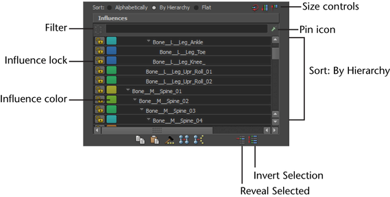

The Influences list and Skin Clusters list are linked
These options let you set how joints are displayed in the Influences list. Select from the following options:
Sorts the joint names alphabetically.
Sorts the joint names by hierarchy (parent-child) and displays them as branches that you can expand and collapse. The top of the list shows the root joint of the hierarchy.
This option is useful if you are painting a single a region of the skin—the joints you need to select from the list while painting are typically next to one another.
Sorts the joint names by hierarchy, but displays them in a flat list. Parent influences still display above child influences in the list, but you cannot expand and collapse the influences.
Resets the
Influences list to the default size.
Influences list and display more rows.
Right-click the button to open the Row Increments Options window and set how many more rows to display with each click.
Click to shrink the
Influences list and display fewer rows.
Right-click the button to open the Row Increments Options window and set how many fewer rows to display with each click.
This area displays a list of all influences bound to the selected mesh. For example, all joints that influence skin weights for a selected character mesh.
Within the Influences list, you can use the following controls.
Enter text to filter the influences that display in the list. This can make it easier to locate and select influences you want to work with, especially if you have a complex rig.
Pins the influence list to display only the selected influences.
Lets you lock and unlock each influence from receiving weight as you paint.
Opens the Influence color window, which lets you assign a new color to the selected influence.
Click to copy the weight value of a selected vertex. See Copy smooth skin weights.
Click to paste a copied vertex weight value to other selected vertices.
Click to fix selected vertices that have weights causing undesirable deformation on the mesh. Maya assigns the selected vertices with the same weight values as their neighboring vertices, resulting in smoother deformation. See Fix smooth weights.
Click to move the weight values of selected vertices from the first selected (source) influence to other selected (target) influence(s). See also Move weights to other influences.
When you click the Move weights button (or select Skin > Edit Smooth Skin > Move Weights To Influences), the weight values of the selected vertices are removed from the selected source influence and re-assigned to any selected target influence(s).
Click to select all influences that affect the selected vertices. This can help you troubleshoot areas of the mesh where you find unexpected deformations.
Click to quickly reverse which influences are selected in the list. This option is useful in conjunction with the Influences list hold and un-hold buttons.
For example, select only those influences you want to work with, then click Invert Selection to change your selection to all other influences in the list. You can then click to hold all other influences.
Click to automatically scroll the Influences list to display the selected influence. This can be helpful when working with a complex character that has many influences.

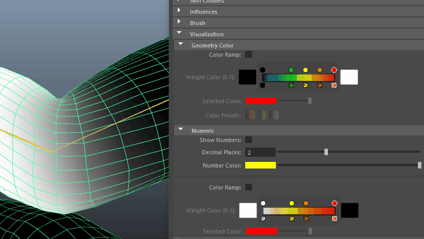

This section covers ways you can view the way weighting influences the mesh, either by using colors to show the strength of the weighting on a specific area or with numbers depicting precise values.

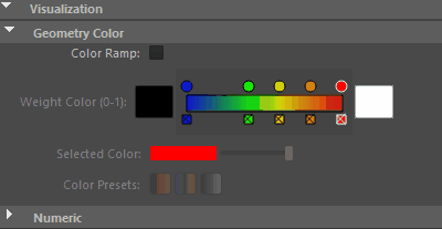

Different Color Ramp types
When Color Ramp is on, you can use the Weight Color ramp and Selected Color options to customize the color ramp. You can also select one of the Color Preset options.
Click to open the Color Chooser window and set a new color for a selected part of the color ramp. Only available when Color Ramp is on.
Select from three pre-defined color ramp options.

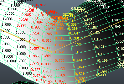

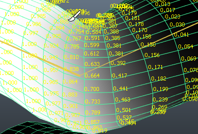

Weighting with both color ramp and numeric values
Skin weight showing 3 Decimal Places
Skin weight using a Color Ramp
Click to open the Color Chooser window and set a new color for a selected part of the color ramp. Only available when Use color ramp is on.

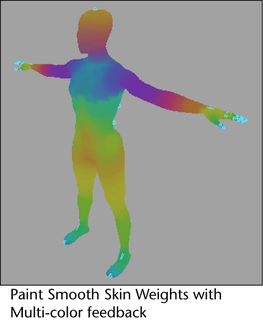

Turn on this setting to view the distribution of painted skin weights on your bound geometry as multi-color feedback. The colors that appear on your bound pieces of geometry correspond to the colors of their skeletons’ joints and bones, and they indicate the areas of skin each of their joints affect. You can view Multi-color Feedback in the scene view when in Vertex mode or when using the Paint Skin Weights Tool.

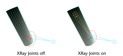

Turn this option on to have wireframe joints display on top of the mesh you are painting. This lets you view the mesh in a shaded mode and easily select wireframe Influence objects without switching between wireframe and shaded views.
