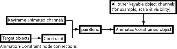

The pairBlend node is automatically generated when both keyframe animation and a constraint are applied to an object. Once the animation and constraint are linked to the pairBlend node, you can modify the weight of the Animation-Constraint blend to generate various effects. See Blend Weights in the Channel Box.

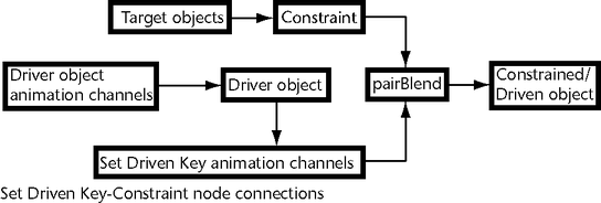

In the dependency graph (DG), the pairBlend node functions as a link between constraints, keyframe animation, and the object to which both are applied. The pairBlend node connections resemble the following: all target objects connect to the constraint node, the constraint node and keyframe animation connect to the pairBlend node, and the pairBlend node connects to the object.
When multiple constraints are applied to the same object, a separate pairBlend node is created for each constraint and the keyframe animation channels of the constrained object connect to the same pairBlend node as their related constraints.
