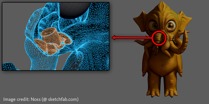

- Internal faces can result in many nonmanifold vertices. The
Cleanup command can remove simple instances of this, but in complex cases its solution may be to split the vertex. Unfortunately, this will result in a hole, which is also problematic for
Retopology. Using the
Merge command to recombine these vertices will again lead to non-manifold vertices (thus getting into an endless loop).
If this happens, we recommend setting the
Cleanup command to
Selecting matching polygons mode, then run it with the
Nonmanifold geometry option turned on. This will select all non-manifold geometry without fixing them, at which point you can inspect them and perform a manual fix by removing the internal geometry associated with the problem areas.

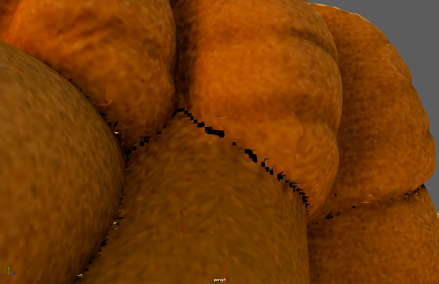

- Holes in faces will also cause problems for
Retopology. Your mesh must be watertight for the algorithm to perform properly. Unfortunately, running the
Fill Hole command on a mesh with nonmanifold geometry will often result in even more nonmanifold geometry, so you will need to weld these vertices manually.
