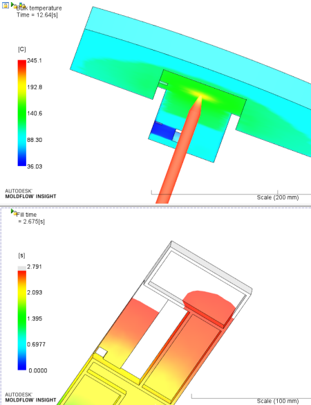

  4. Select the Bulk temperature result from the Study Tasks pane.
  5. Click play icon ( Results tab > Animation panel > Play). A simulation of the bulk temperature is displayed. Note how the cooling of the part after filling is best represented with an animation. The hot runner is also shown to retain most of its heat as expected.
    Note: Only relevant tools in the Animation panel are activated at one time. Not all results can be animated.
  6. Select the Fill time result and view an animation of the fill time.
  7. Rotate the model to 180 100 70. (Click View tab > Viewpoint panel > Rotation Angle)
  8. Zoom in on the end of the model.
  9. Click lock animation icon (View tab > Locking panel > Lock Animation).
  10. Click split horizontal icon (View tab > Windows panel > Split > Split Horizontally).
  11. Click in the lower window to make it active and select the Fill time result from the study tasks pane.
  12. Rotate the model to -170 -25 55 and zoom in on the tail of the model.
  13. Click lock animation icon (View tab > Locking panel > Lock Animation).
    Note:
    • The individual images maintained their orientation because you have locked the animation but not the view of the part.
    • Only animations with the same number of screens can be viewed simultaneously.
  14. Click play icon (Results tab > Animation panel > Play).
  15. Click step back icon Step Backward twice, and click step forward icon Step Forward once.
    The difference in time for the extremities of the model to be filled is illustrated. This could cause overpacking in the first section that is filled.
