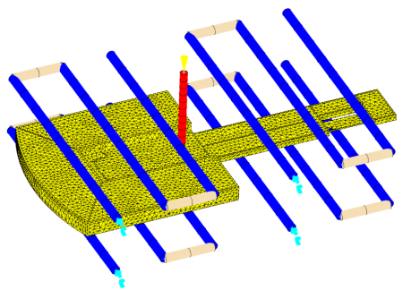

The tutorial model is shown in the image below:
task 1
Note: You might have to activate the Hot Runner and Channel layer to view all of the model elements.

  8. Click view orbit icon (View tab > Navigate panel > Orbit) and rotate the model to examine its geometry and features. Notice in the Study Tasks pane that the tutorial model is represented by a Dual Domain Mesh. It contains one injection location and four cooling circuits.

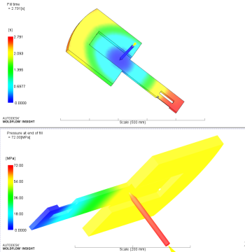

  10. Click split horizontal icon (View tab > Windows panel > Split > Split Horizontally). The screen is split and a duplicate of the model is displayed in the lower portion of the screen.
    The split pane tools work as a toggle. Use the tool to turn the splits on and off. Turning a split off removes any specific formatting settings for that pane.
    Note: The dotted line inside the a pane indicates the active pane.
  11. Click inside the lower pane. This is now the active pane.
  12. Select Pressure at end of fill from the Results section of the Study Tasks pane.
    Note: The analysis result type is displayed in each model pane.
  13. Rotate and zoom in on a section of the model and note how the image in the upper pane has not altered. This allows you to view different results in different parts of the model.
    split screen
  14. With the bottom pane still active, select Fill time from the Results section of the Study Tasks pane. This allows you to view the same result in different parts of the model.
