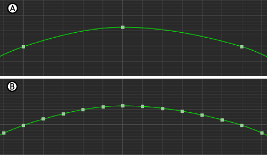

Resamples the selected region by creating keys on the curve.
When you select the Resample filter in the Filters window, you can set the following parameters:
Lets you determine the amount of keys that are created. The equation works as follows:
Action timeline Frame Rate / Resample Frame Rate equals the frame rate at which keys are added.
For example, if your Action timeline Frame Rate is set to 30 FPS and you set the Resample Frame Rate to 15, the equation calculates a value of 2 (30/15=2). Therefore, a keyframe is added every 2 frames.
Snaps all keyframes to the nearest frame (see Keys on Frame filter).
Resample A. Original curve B. Resample applied
