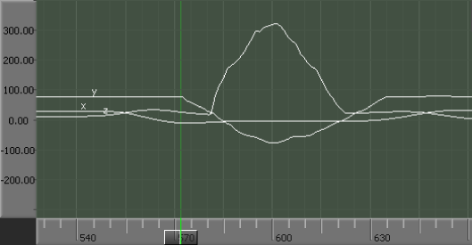

Just before a marker disappears from occlusion, it may be partially occluded, causing noise, peaks, or other jumps in the capture data. During playback, you may notice that the marker appears to be moving normally, then it begins to fly off on an incorrect tangent. The Quality Bar shows this as a black area. These normally appear near the end of a data segment.
Gap interpolations are also used to interpolate between two segments where there is noise. The segment that contains the noise is split, then removed. Gap interpolation reconnects the two segments.
You can't undo optical segment actions in the Timeline such as Split Segment, Remove Segment, and Reset Segment.
Place the Timeline indicator at the beginning of the noise as shown.
Timeline indicator positioned at the beginning of the noise

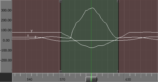

Because the Timeline indicator is placed in a segment, the Segment menu is activated in the Optical Options pane.
Click Split Segment in the Segment menu. The segment is split into two separate segments.
Place the Timeline indicator at the end of the noise in the new segment, and split this segment as described in step 1 and 2.
You now have three segments with the center segment containing the noise to be removed.
Two segments created
Place the Timeline indicator inside the segment to be removed and click Remove Segment in the Segment menu.

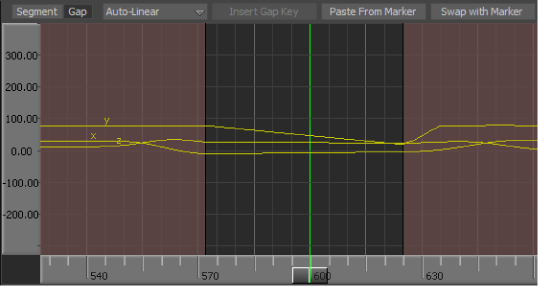

A gap is created. By default, its interpolation is set to Auto-Rigid Body which calculates the data based on the Rigid body.
If you want, you can change the Gap Interpolation. For example, the following figure shows the gap using Auto-Linear interpolation.
Gap interpolated using Auto-Linear interpolation
