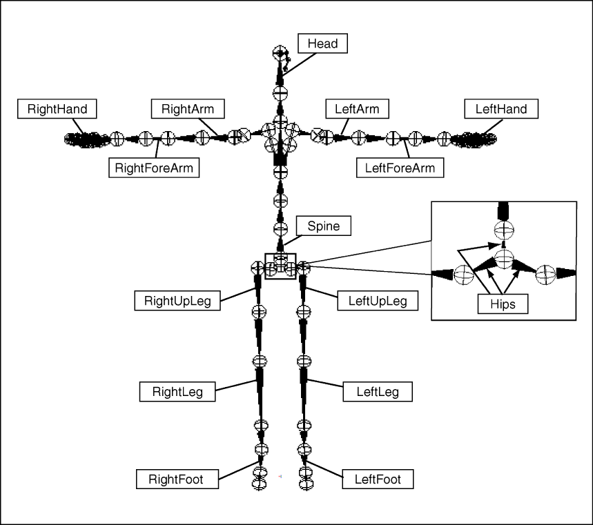

The Mapping List requires that you indicate a minimum of fifteen required bones, as illustrated in the following diagram.
Basic skeleton with Base bones labelled
