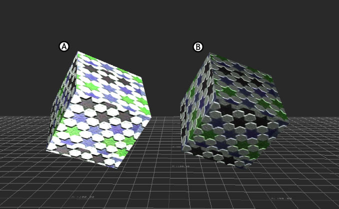

This lets you simulate roughness or smoothness, depending on how the texture reflects light, such as in the image below.
Bump Map shader A. An object with no shader. B. The same object with the Bump Map shader

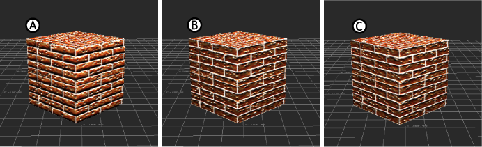

Select either the U or V Invert Bumps option to choose which UV coordinate creates the Bump Map texture.
Choosing either U or V inverts the normals of the Bump Map in order to create the opposite texture effect. For example, raised textures appear lower and lower textures appear raised.
The U and V direction can be important if, for example, you were using a brick wall texture and you did not want the mortar to stand out beyond the brick surface.
Invert Bumps A. U is activated. B. V is activated. C. Both U and V activated
Activating both the U and V settings flattens the texture’s appearance.

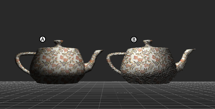

Activate the Enable Bump Lighting option to use a more accurate per-pixel lighting effect on the bump texture, instead of vertex-based lighting. Using Enable Bump Lighting creates a dramatic contrast on the object.
The Enable Bump Lighting option uses only one light to create its effect.
Enable Bump Lighting option A. Disabled B. Activated
