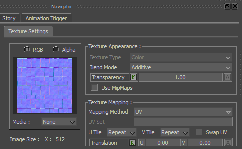

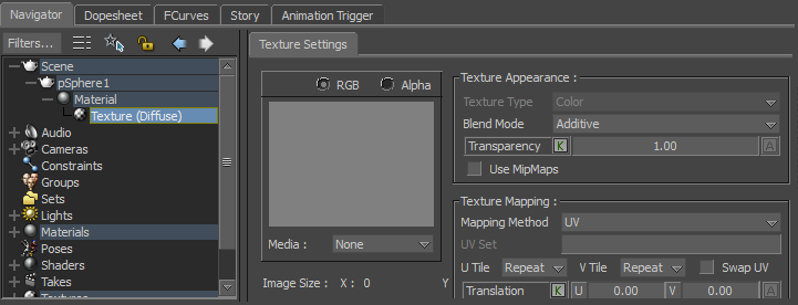

In the Scene browser, double-click Texture (Diffuse) to access the Texture Settings.
Navigator window Texture Settings pane
In the Texture Settings pane, click the Media field.
The Media field includes three options.
Click New media....
In the Import Video dialog, select a file to use as a texture for the object and click OK.
The Viewer window displays the texture applied to the object.
The Texture Settings pane displays the preview of the texture.
Navigator Window Texture Settings pane
The Navigator Scene browser displays the name of the imported file used as the texture for the object.
The Material Settings pane displays the preview of the texture and the texture applied to the Material Settings Diffuse property.

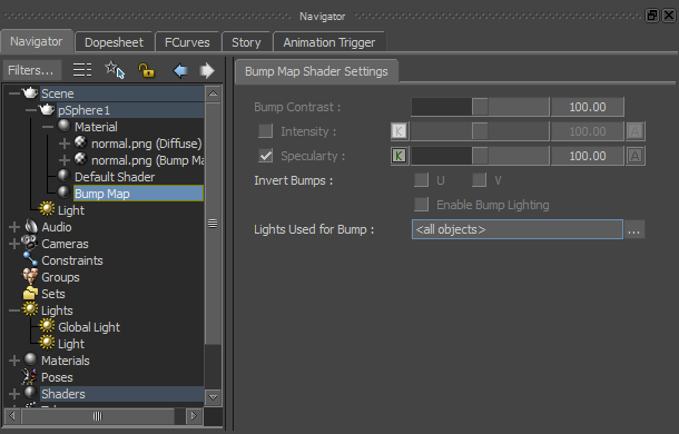

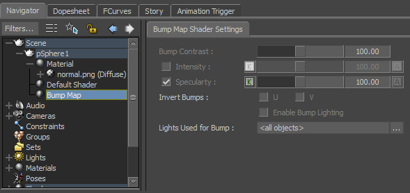

In the Navigator window, the Bump Map Shader Settings pane displays and the Scene browser displays the Bump Map attached to the Material.
(Optional) In the Scene browser, expand the Shaders branch.
The Bump Map shader is added to the branch.

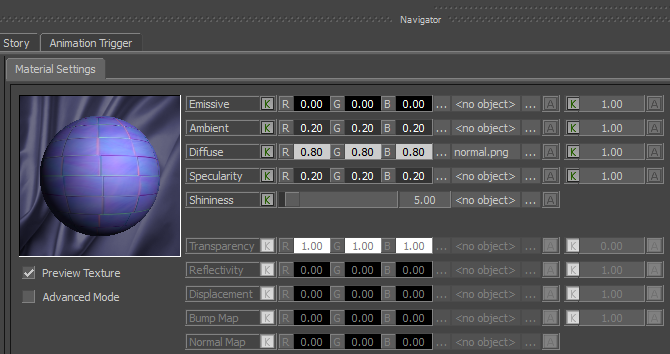

In the Navigator Scene browser, double-click the object's Material branch to access the Material Settings.
Material Settings
The Material Settings pane displays a texture attached to the Material's Diffuse property, and a thumbnail view (Preview Texture) of the texture.
The Material's Transparency, Reflectivity, Displacement, Bump Map, and Normal Map properties are not available when the Advanced Mode is disabled.

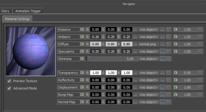

To see the result of the Bump Map texture in the Viewer window, you need to add a Bump Map shader to the object, attach the texture to the Material's Bump Map property and add a light to the scene.

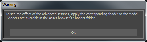

In the Material Settings, enable Advanced Mode.
A warning message displays.
The Material Settings Advanced Mode enables you to access the settings that require a shader to display the result in the Viewer window.
Click OK.
The Material Settings in the Advanced Mode are now accessible.

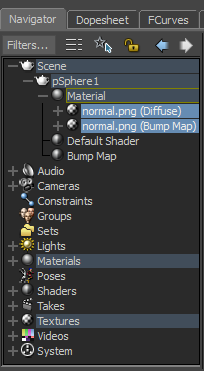

In the Navigator Scene browser, under the object's Material branch, drag the texture *.* (Diffuse) in the Material Settings pane onto the Material's Bump Map property (
The Navigator Scene browser and Material Settings pane show the texture is now attached to the Material's Bump Map property.

(Optional) To fine-tune the Bump Map effect:
In the Navigator Scene browser, double-click the Bump Map shader to access the Bump Map Shader Settings.
In the Bump Map Shader Settings, fine-tune the effect by enabling Intensity and changing the Bump Contrast, Intensity, and Specularity values, and by enabling Invert Bumps and Enable Bump Lighting, and by choosing a Light to use for Bump.
