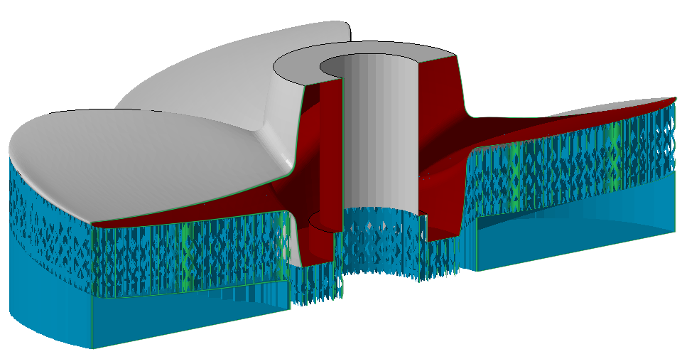

The stacked support on this propeller example generates fully autonomously from only two support actions in mere seconds.
This tutorial shows setting up and generating hybrid support using a support script. While the support actions that comprise the script may be configured and performed manually, using a script saves time and is most importantly reproducible with minimized chance of error.

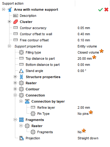

Action for the solid section
The first support action, configured to produce the solid section of the hybrid support, with the important changes marked with an asterisk

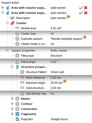

Action for the open section
The second support action, configured to produce the open section of the hybrid support, with the important changes marked with an asterisk
With the two actions now configured, click Save. The support script is now ready to run.
