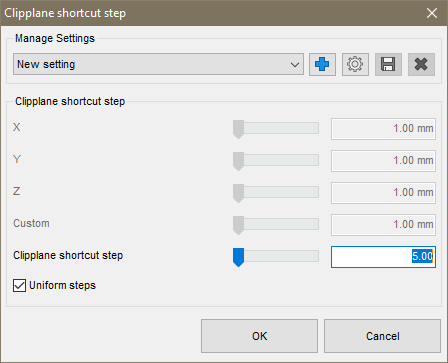

Configure the steppings and save them as an easily recalled setting

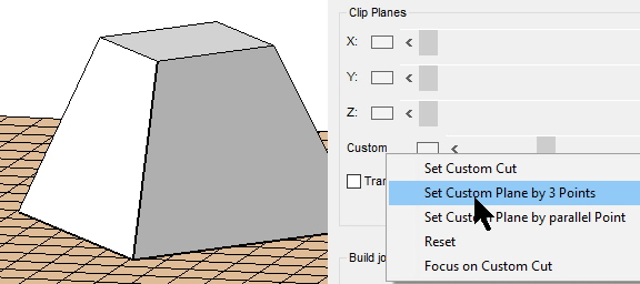

The custom clip plane lets you view the cross section of parts at any angle, not just perpendicular to X, Y, or Z.
To angle the plane parallel to a triangle
To angle the plane through three points

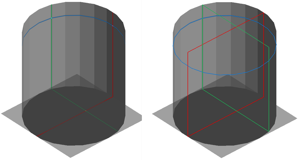

To select which side of a clip plane to show or hide (or make transparent, if set), click on the box between the axis name and the slider.
Toggle visibility of the section towards the negative of the view axis
Toggle visibility of cross section highlighting
Toggle visibility of the section towards the positive of the view axis
Visualize cross-sections by switching the clip planes to show on inner sections, too.
Focusing turns both sections from a clip plane invisible and only leaves the highlighting visible. It also changes the perspective so that you can see it straight on.
