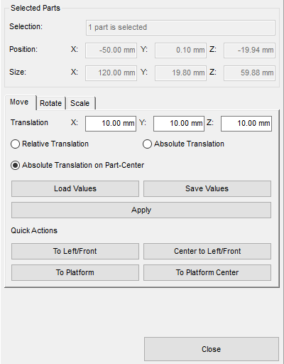

TopThe commands Move and Rotate are located in the main menu, in the Arrange category; the Scale command sits in Modify.
They are also available in the context menu of a part, both in the project tree and the 3D view.
Once called in either way, the context view switches to show the appropriate input fields and buttons. Here you can make use of shortcut buttons that send the selected part to the platform center, or fill the rotation angle field with a value.
Numerical controls and presets for transforming a part (shown here: moving) are conveniently available in the context view.

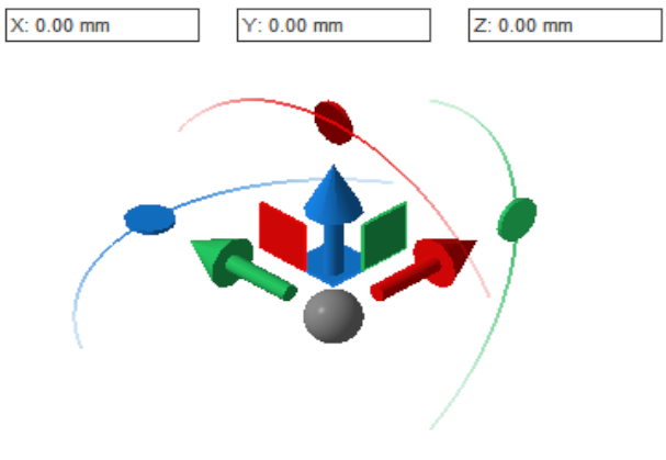

A set of manipulation handles, across Autodesk software known as gizmo, appears while the transformation controls are active. The gizmo itself does not have controls for scaling, however.
You can switch the gizmo to become active as soon as a part is merely selected, using .
Every element of the gizmo provides interactive control.
You can click and drag or rotate a part by its center marker and the corners of the bounding box bracket:
Clicking and dragging the center marker moves the part parallel to the display's depth plane.
Clicking and dragging the bounding box corners rotates the part around the virtual optical axis of the display.
This is helpful for when you have switched the gizmo to only appear when you actually use any of the functions Move, Rotate and Scale.
