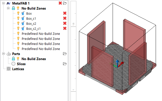

In this example, the zones at the corners are machine-specific, the zones along the sides are user-defined. All are listed in the project tree. The user-defined zones are also explicitly set to be observed by the support editor.
Part platforms, including those provided by machine workspaces, have a No-build zones section in the project tree. Moving parts into such sections turns those parts into no-build zones:
Custom no-build zones are stored in a FABBPROJECT file, and they are also storable with a customized machine in My Machines.
In addition, some machines come with zones already defined. These zones are part of the machine workspace definition and cannot be modified.
