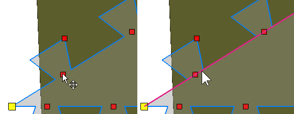

Mouse controls for edge feature configuration
Point exactly at the base point first, then hold Alt, then drag. (left) If the edge becomes highlighted, Alt+Click straightens the edge instead. (right)
