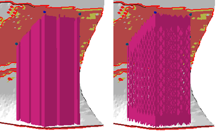

Filling type
Switch the support walls between Closed volume (solid) and Structure.
  • The fragments that make up closed volume supports are essentially box-shaped columns. They are closed on all sides, even at top and bottom. The connection with the part surface is facilitated by small pins.
  • Structure supports are, by default, akin to patches of intersecting wire fence. Also, the entire cluster area is enclosed by a single wall along the circumference, ie. the cluster's contour.

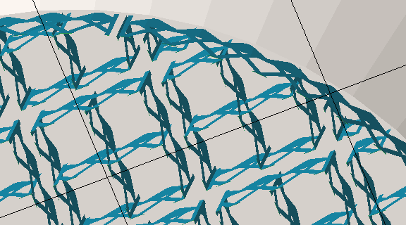

Applied default closed-volume supports. A cut via clip plane demonstrates the cluster's contour, the fragments' cross section, the terminating surface at the top, and the stand-off against the part surface.
Applied default Structure supports. Note the gap in the circumference.

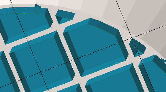

Fragments
Fragmentation creates gaps in normally continuous polyline support. Gaps make support easier to break off.

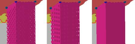

Structure pattern
Switch between Wired wall (left), a Punched plate (middle), and Plain (right) to determine the wall pattern of volume supports.
Width and Height
Width and height of the hole shapes.
  • For Wired wall and Punched plate only
Interval width and height
Distance between neighboring holes to the sides and to those above and below.

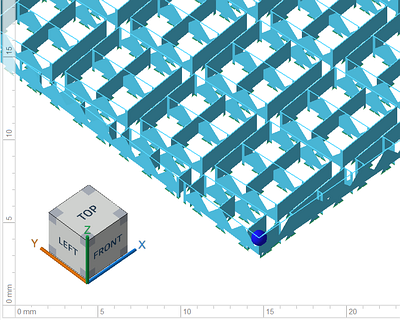

Raster
The raster is built up from intersecting polyline walls and fills the actual volume of volume support.
Rotate by Z
Sets the general alignment of filling structures. Filling structures are aligned globally, as in, against the platform coordinates.
Hatch distance
Sets the distance between the inner structure units. The number of inner structure units and the density will be affected.
Note: Not applicable to/available for Closed-volume-type filling.
Filling strategy
Defines in which directions the outer contours of the volume supports will be filled: In both X and Y direction, just in Y, or no filling at all.
Notes
  • The equivalent of Just in X can be created by using Just in Y and setting Rotate by Z to values around 90°, up to 180°.
  • Not available for Closed-volume-type filling.
Distance to Contour
To enforce a distance between the internal volume support entities and the enveloping polyline, set this beyond zero. If it is zero, the raster's walls terminate directly at the contour.
Note: This is always measured from the innermost contour, in particular if you have set Contour count (see below) to values beyond 1.

Fragments
Fragmentation of volume supports into individual blocks makes it easier to break the supports from the part.
Raster
Turn fragmentation on or off.
Fragment size X
Fragment size in X direction
Fragment size Y
Fragment size in Y direction
Fragment gap
Sets the gap width between volume-filling fragments
X and Y shrinkage
Shrinks the fragment at the bottom end, to have a wider fragment at top, whose size decreases to the set value
Offset in X and Y
Sets a distance by which to displace the raster-fragmenting gaps against the filling. Can also be negative.
Contour
The cluster-enveloping contour can be fragmented as well, using this toggle.
Fragment contour length
Defines the length of a fragment unit
Fragment contour gap
Defines the gap width between two envelope polyline fragments
Fragments
Toggle whether the gaps in the enveloping contours should be aligned with the gaps that the fragments themselves have.
