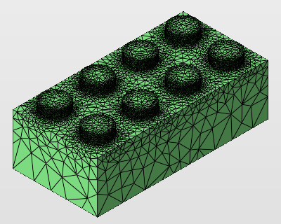

Adaptive remeshing
This is a way to remesh that maintains intricacies where needed while saving on triangles where the surface is less detailed.
Options
Remeshing adaptively maintains finer detail while saving on triangles in less detailed areas.

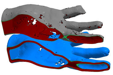

Manifold remeshing
This reconstructs the original mesh with new, regular triangles. Holes formed by open triangle edges are wrap around to the inside to generate a thickness to the mesh and close the seam. This way, while not closing the holes themselves and making the mesh fully solid, the method ensures that the part on the whole becomes printable, if hollow.
Note: The output of this method is generally thicker than the original mesh.
Options
The flawed mesh (top) has been turned into a closed mesh with a thickness (bottom).
