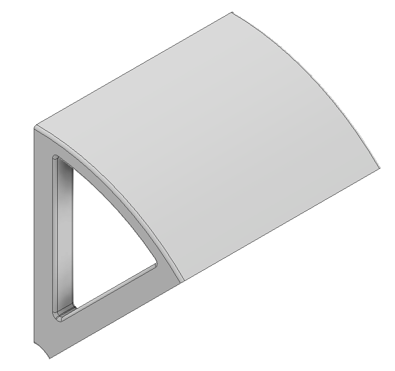

This tutorial uses a Wheel Arch model to illustrate a simple linear static analysis. It introduces the following:
