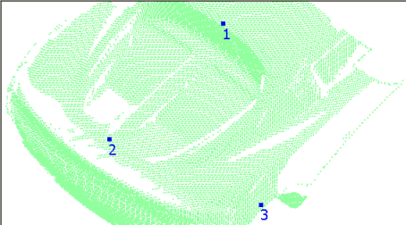

  3. In the first point cloud, left-click the points that you want to match to the overlapping area of the second point-cloud. The selected points are displayed as numbered blue squares so you can identify the order in which they were selected. You must pick at least three points. For example:
    To deselect a point, left-click it again; to deselect all selected points, press the Esc key.

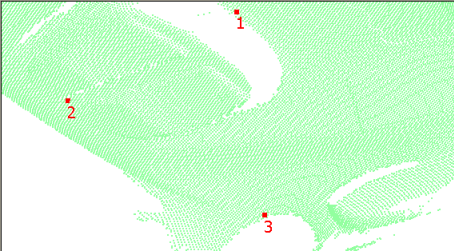

  4. In the second point cloud, left-click the points that correspond to the points you selected in step 1. The selected points are displayed as numbered red squares. For example:
    You must select one point for each point selected in the first point-cloud. The locations of points in the second point-cloud do not have to correspond exactly to the locations of the points in the first point-cloud, but the closer the correspondence, the more accurate the initial match between point-clouds.
