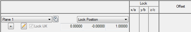

  3. Select the plane in the left drop-down list, or click and select the feature in the CAD view. For example:
    This locks the two rotation axes determined by the orientation of the plane.
  4. Choose an option in the right drop-down list. Select:
    • Lock Position to fix the orientation of the plane and lock the plane in position along its normal.
    • Lock Direction to fix the orientation of the plane. This locks two rotation axes, but leaves the position free to move along the axis normal to the plane.
