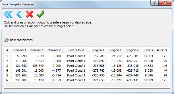

The Pick Target / Regions dialog is displayed when you click Add or Modify in the Point Cloud Picked Points Alignment dialog. Use it to match points on the CAD model to regions in point clouds when you are creating a Point Cloud Picked-Points alignment. For example:
The dialog is divided into two sections:
to delete all target-region pairs from the list.
to delete the last target-region pair you created.
to close the dialog without saving your changes.
to close the dialog and save your changes.
To display the list, select the Show coordinates check box.
