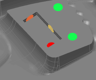

To display surface points
To display the measured points of surface inspection groups in the CAD view, select View tab > View Options panel > Points button.

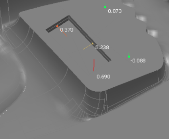

PowerInspect compares the measurement results to the CAD data and uses colour to indicate the deviation from the CAD data:
To choose the type of display, click the arrow and select:
To hide the inspection points, deselect the button.
