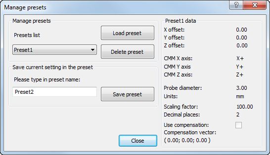

To manage the DRO presets
Presets enable you to save and load snapshots of the DRO values. Use them to save time when you need to regularly configure the DRO with the same set of values.
Note: The DRO is available only for use with CNC and Manual machines.
To create a preset:
  1. Click Tools tab > Machine panel > DRO.
  2. Configure the PowerInspect DRO dialog to the values you want the preset to contain.
  3. Click Manage presets. The Manage Presets dialog is displayed.
  4. Enter a name for the preset in the Please type in preset name box, and click Save preset.
  5. Click Close.
To load the values from a preset:
  2. Click Manage presets to open the Manage Presets dialog.
  3. In the Presets list, select the preset whose values you want to use, and click Load preset.
  4. Click Close.
To delete a preset:
  3. In the Presets list, select the preset you want to delete, then click Delete preset.
  4. Click Close.
