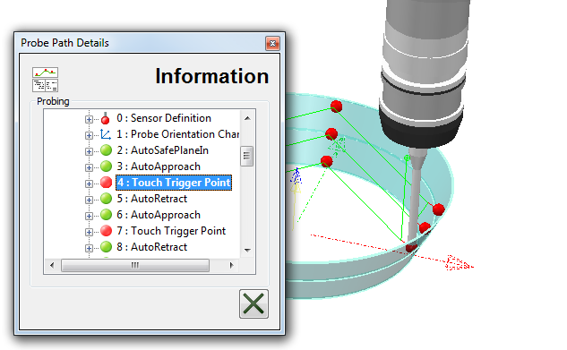

To step through each move in the probe path:

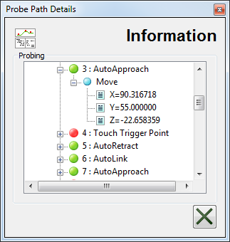

  1. In the Inspect dialog, click the Details button. The Probe Path Details dialog is displayed.
    If you want to view more details about a move, click . For example:
  2. Click to close all the move details in the path.

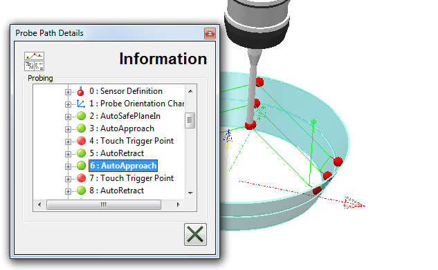

  3. Select a move in the probe path. In the CAD view, the probe is positioned at the start of the move. For example:

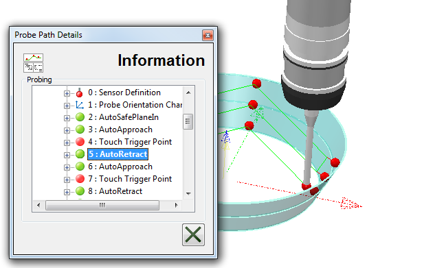

  4. Select the next move entry to show the probe move in the CAD view.
  5. Continue to select the moves to step through the probe path.
