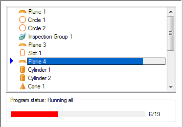

The Progress area lists all the measurable items in the inspection sequence. When you simulate the inspection sequence or run the sequence on a CNC machine, the area shows the item being measured, the current move, and the total number of moves in the item's probe path. In addition, the Program status bar at the bottom of the area indicates the position of the current item in the sequence; the number of items in the sequence, and whether the sequence is stopped (Inactive), running automatically (Running all), or running one item or move at a time (Running one step). For example:
