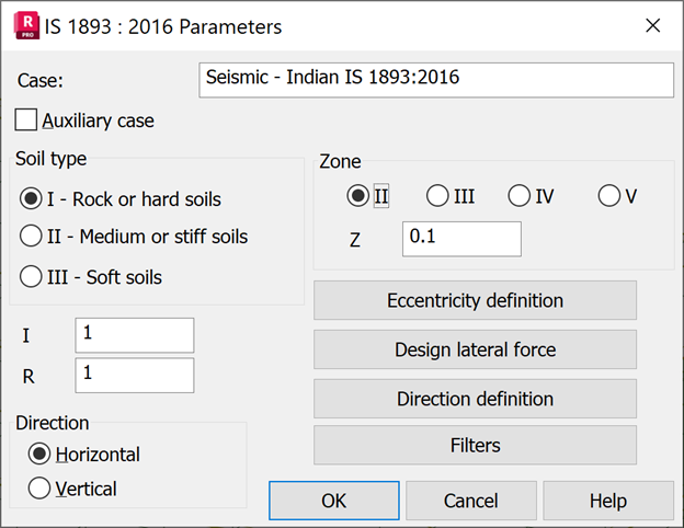

Parameters of a structure seismic analysis depend on a seismic code used during calculations of a structure influenced by seismic impact. Select Indian seismic code (IS 1893) in the New Case Definition dialog or click Parameters in the Analysis Type dialog.
To complete the seismic analysis according to the rules given in this code, define the following parameters:
given in IS 1893 (Parts 1 to 5), clause 6.4.2 Table 3, the value is assigned according to the choice of seismic zone. For determining design seismic force, the country is classified into four seismic zones (II, II, IV, V) as shown in Figure 1.

The design horizontal seismic acceleration coefficient Ahis based on the above factors, according to the formula 6.4.2 expression (b).
The design vertical seismic acceleration spectrum Av is determined accordingly by the formula 6.4.6 for building governed by IS 1893 (Part 1).
You can examine all the input parameters and base shear force distribution in the Calculation Notes (open Analysis > Calculation Notes > Simplified/Full Note)
In the lower part of the dialog, the the Direction definition and Filters buttons are located.
There is the additional button Design lateral force; click it to open the Base shear dialog. According to clause 7.7.3 base shear estimated by the Response Spectrum Method shall not be less than the design base shear calculated using a fundamental period Ta as per 7.6.2. You may choose different options to define fundamental period Ta or design base shear force value. Pay attention that internal forces, stresses and reaction will be scaled so that sum of reaction for quadratic combinations is equal to the design base shear.
