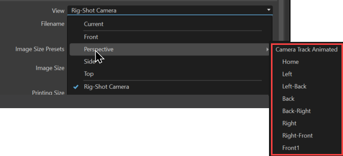

View establishes which view is used for rendered image calculation. All viewpoints, pre-defined camera track animations, or variants (if camera was active on its creation) can be selected from the drop-down menu. If a track is chosen, all contained viewpoints are rendered automatically.
Using View can simplify batch rendering of variant sets by combining viewpoints with variant sets and rendering out images for each combination.
The render session is now made based on the combination of viewpoints with the selected variants. Each output image is named for easy identification. For example, with variants as the naming priority:

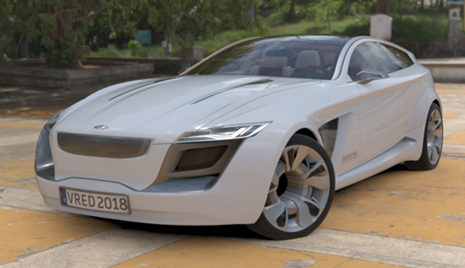

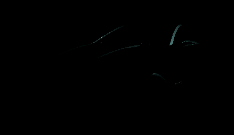

Beauty - Produces a default rendered image. Use it as a comparison image against the final image. The beauty image can be composed from either the Combined channels or Separate channels.

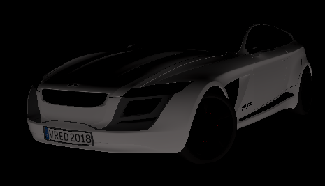

Diffuse IBL - Produces an image of the diffuse illumination of the active environment multiplied by the material's diffuse color.

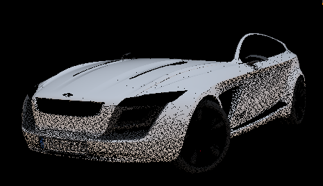

Diffuse Light - Produces an image of the diffuse direct illumination of all light sources in the scene multiplied by the material's diffuse color, such as from a lightbulb.
Diffuse Indirect - Produces an image of the diffuse indirect illumination multiplied by the material's diffuse color.

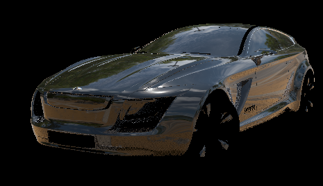

Glossy IBL - Produces an image of the glossy reflections from the active environment in the scene, multiplied by the material's glossy color.

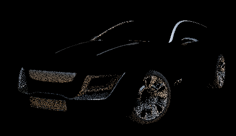

Glossy Light - Produces an image of the glossy reflections from all light sources in the scene, multiplied by the material's glossy color.
Glossy Indirect - Produces an image of glossy reflections from surrounding objects.

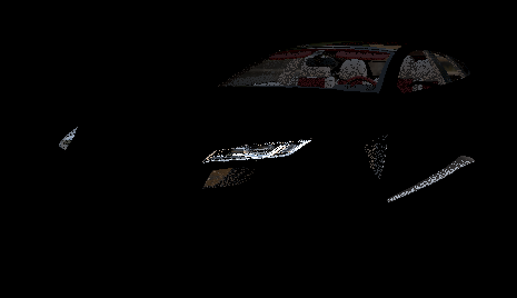

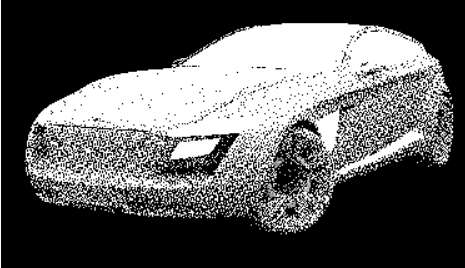

Specular Reflection - Only generates the specular (perfect mirror) reflections from materials like chrome, multiplied by the material's specular color.
Incandescence - Separates all self-illuninating parts of an image from the rest. Use for adding a glow around light sources when compositing.
Translucency - Produces an image of the translucency and subsurface scattering contributions from the materials, using those options.
Transparency Color - Produces an image of all transparent surfaces and colors behind the surfaces, including glass refractions.
Volume Color - Enables volumes to be rendered to a separate pass in raytracing and to be viewed in the 3D viewport. Ensure CPU or GPU raytracing is activated and the corresponding channel from the Visualization menu > Renderpasses Rendering > Combined Channels > Volume Color is enabled.
Background Color - Produces a full color image of the background with the opaque geometry black and transparent grey.

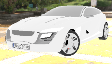

Diffuse Color - Produces an image showing the material's diffuse color.

Lights Diffuse - Produces an image showing the diffuse direct illumination of all light sources in the scene.

Indirect Specular - Produces an image showing the specular (perfect mirror) reflections from materials like chrome.

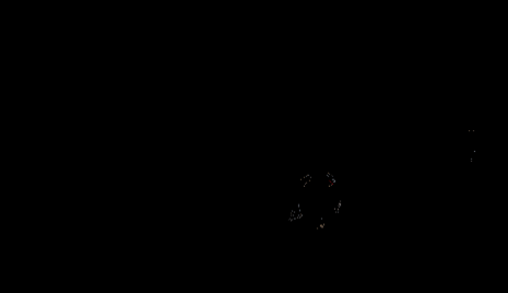

Used to add some additional effects to the final image when using compositing tools. Use it for basic lighting or combinations of different renders based on the depth buffer of the albedo and camera normal buffers as input for some denoising applications. These buffers are not necessary to recreate the beauty image from the renderpasses. Auxiliary Channels contains the following buffer options:
Albedo - Enables the denoising to run independent from VRED. It is the surface color and an unshadowed uniform white illumination and produces an image texture without shadows or highlights.

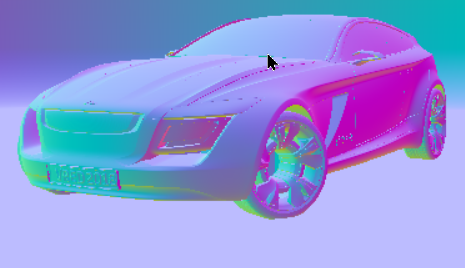

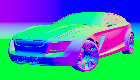

Normal - Produces a colorful image of all 3D shading normals visible in world space. Use it for relighting a scene.

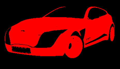

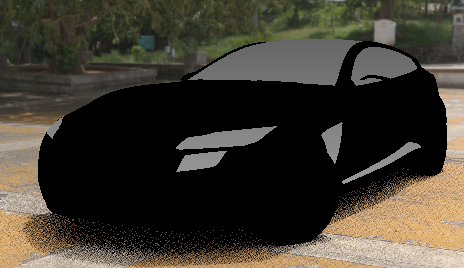

Mask - Corresponds to the alpha channel of the beauty image. This can be used to render the renderpasses without alpha and then add the alpha with the Mask pass in compositing.

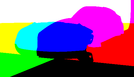

Material ID - Use to generate color masks for compositing programs. This pass needs to be adjusted in advance in the material settings of the respective geometry.
Depth - Produces an image that isolates the scene's depth information. It creates a black and white gradient, based on the distance the objects are from the camera and the camera's near and far plane values. Whites are close to the camera and black is very far.

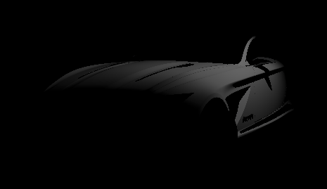

Occlusion - Produces a greyscale image that simulates the self-shadowing in the scene.
Camera Normal - Produces an image showing the 3D shading normals in camera space.
Position - Produces an image showing the 3D positions in world space.
View Vector - Produces an image showing the 3D view vector in world space, same as the positional normal.

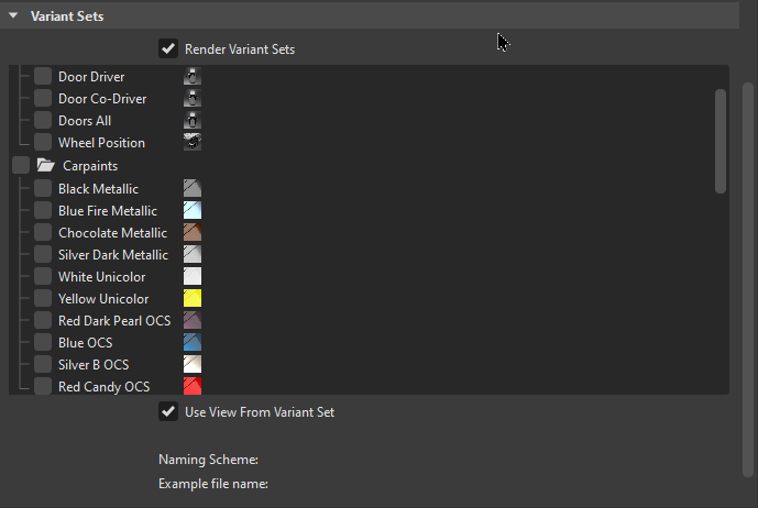

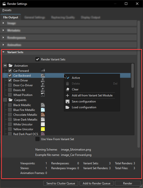

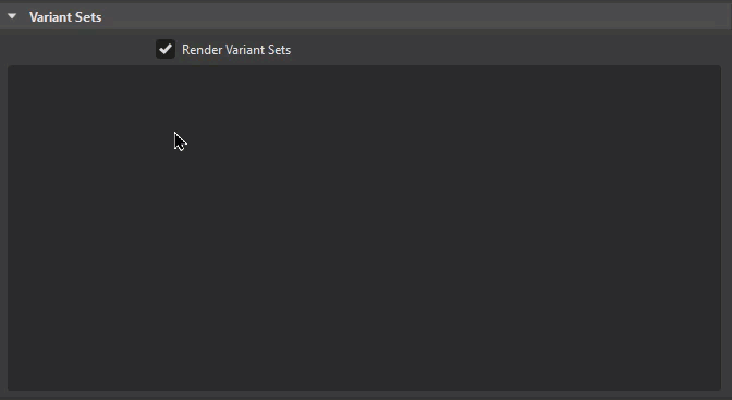

Variant Sets
Variant Set Render Video Captions: In VRED 2020.3, we are now able to set and control variant sets within the Render dialog and render out different render set combinations in one go. Just drag the VSets into the new Variant Sets area of the Render Settings. Here you can enable and disable them to define which one to render. Within the context menu, you are also able to store and load the configuration. You can also enable Use View From Variant Set, in case you store a few within the VSet. This is automatically disabled if you choose to render a camera track, under View. Below, you can see a preview of the filenames that will be created. The order of the variant sets will define your filename. At the bottom of the Render Settings, we have added an area, which gives you some useful information, like the total amount of renders that will be created. Once you set up all your variants in the Render Settings, you can also add the complete job to the Render Queue. This new render option will speed up your rendering workflow, immensely, when working with variants and a massive amount of imagery. Thanks for watching the video.

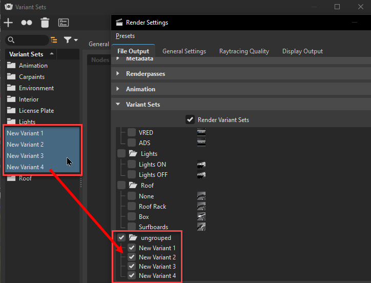

Use the Variant Sets section to easily render multiple versions of a model in VRED. Render a red car in a garage, yellow car in a garage, and red car in park, in one render job. Material and environment variant sets can be set by checking what's wanted and unchecking what's not.
If you reorder groups by click-dragging, this changes the render and naming order of your files. Reordering is not permitted on a per variant set basis, only with groups.
When ungrouped variant sets are dragged from the Variant Sets module to the Variant Sets section of Render Settings, they will be grouped under the same parent node, named ungrouped. This treats all ungrouped nodes as if they belong to one group to simplify deleting, dragging and dropping, and selecting/deselecting.
Enables variant sets to be added to the render job. Right-click to access a context menu with the following options:
Active - Adds checks to all selected variant sets (materials, geometry, and environments) in the Variant Sets section and adds their information to the Render Summary at the bottom of the module.
Delete - Deletes entire folders of variant sets from the Variant Sets section.
Clear - Clears all variant sets from the Variant Sets section and removes all information from the Render Summary below. To add them back, use Add all from Variant Set Module.
Add all from Variant Set Module - Adds all variant sets in the current scene to the Variant Sets section. Check a variant set to render it. To select everything in a folder, check the folder. To deselect everything in a folder, uncheck the folder.
Save configuration - Saves the configurations as an XML file. This is useful to keep along side your VPB files to get the same rendering results another time.
Load configuration - Reloads the XML configuration file for design reviews, so you have the same results as before.
Use View From Variant Sets - Ignores the viewpoint set in the Render Settings module and uses what was set in the view tab of the Variant Sets module.
At the bottom of this section, the naming scheme and an example file name are displayed. The naming of the rendered files uses a combination of the variant set names to form the final file name. A unique indentifier can be added to the beginning, but only at the time when selecting the render job save location.
Please be aware of the following limitations when rendering variant sets:
Only one viewpoint will be used for variant sets containing multiple viewpoints within the Viewpoints variant type. If a default is set and added to a variant set, it will be triggered, regardless of its position in the list. If no default is set, the first variant listed will be triggered.
Any animation in a variant set will be triggered.
Features such as Next, Previous, and Loop have yet to be correctly supported. Please avoid using them for rendering variant sets. These variant sets will be triggered and scenes will change in line with the next/previous state.
Variant names should be short to avoid extra long file names that might go beyond the character limits of your OS.
When combining variant set rendering with animation rendering in the same job, Render Animation must be enabled in Render Settings > File Output > Animation. Select the relevant clip or enter the relevant times within the timeline. The variant set animation will not render, if this is not done. For multiple animations, we recommend they be added to their own render jobs.
