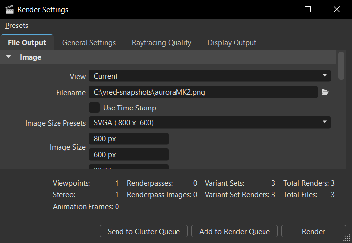

Use Render Settings to adjust the settings that control how the scene renders. Along the top of the Render Settings module is the Presets menu and four tabs, File Output, General Settings, Raytracing Quality, and Display Output.
Once you're finished customizing the render settings, use the Render Summary for a summary of things, such as total renders and files, and more. When finished setting attributes, use the buttons, at the bottom of the module to start image calculations.
Click Presets to display a menu with the following options for saving, reloading, editing, and restoring default rendering settings.

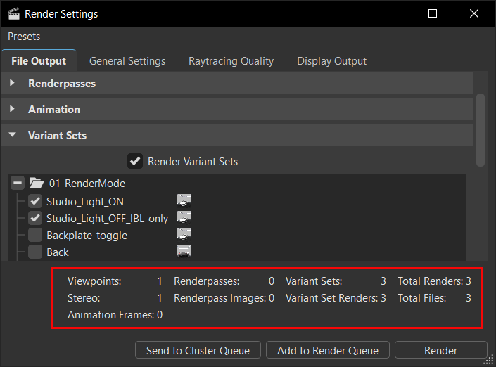

The Render Summary is at the bottom of the module, just above the Send to Cluster Queue, Add to Render Queue, and Render buttons. Get more contextual information about the render and how long it could take. Get the total number of images and renders.
The same information is also available in the Render Queue, just in a different format.
