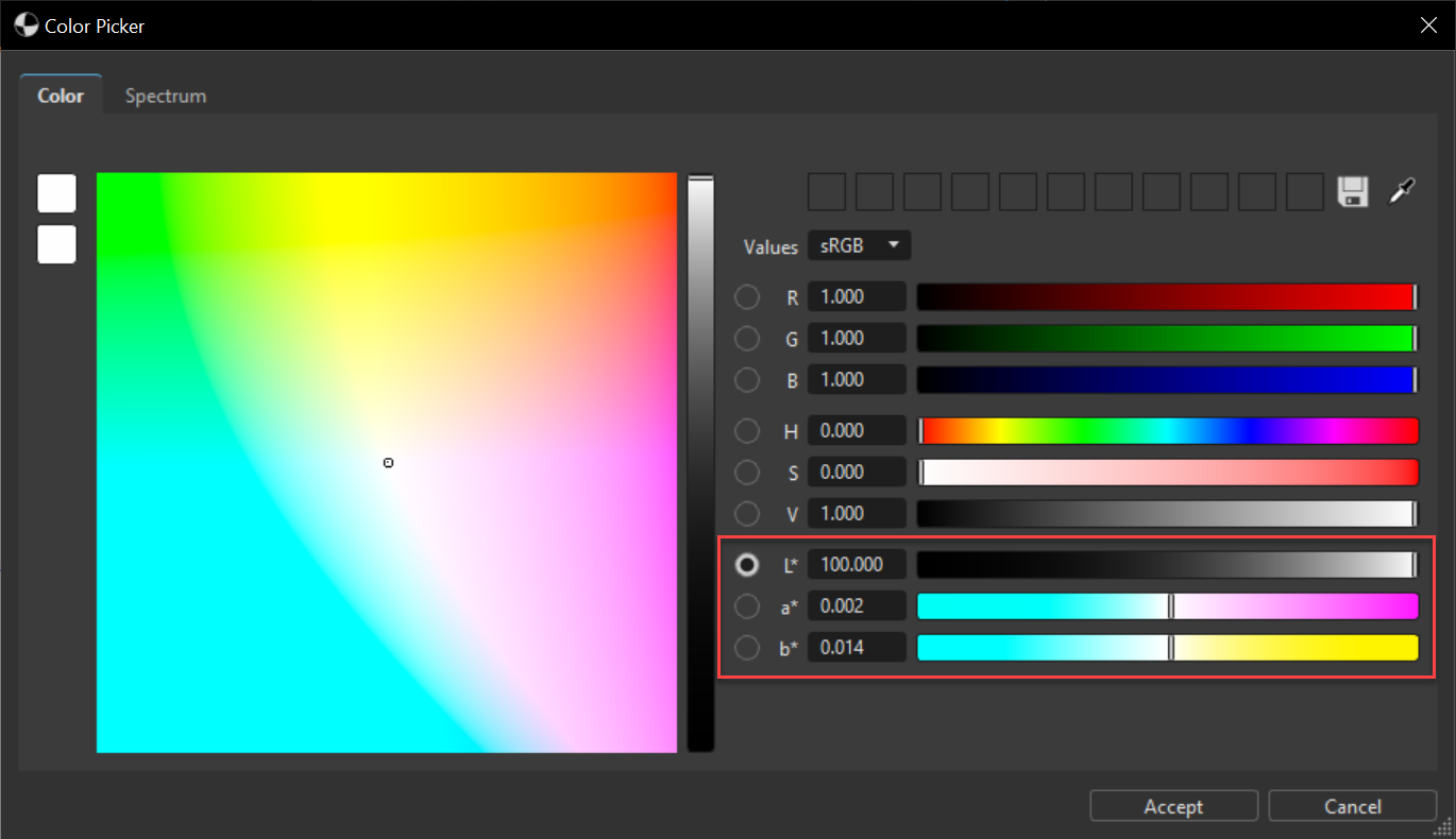

Within the Color Picker of the Material Editor, use the L, a, and b values to edit these colors. These are extremely saturated and outside the sRGB color space. Note that to see them, you will need a display with a wide color gamut.

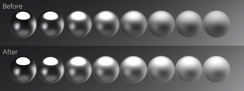

The BRDF shader model better conserves energy. The weighting of the diffuse/glossy/specular layers should consider the glossy/specular colors, in addition to the fresnel reflectivity. The result does not show dark edges when a glossy color turns to black. Instead, it displays a purely diffuse material. This provides better fine-tuning of the specular reflections.
Energy Preserving GGX - Energy Preserving GGX uses a multi-scattering approximation to improve the preservation of a material's energy, especially for high roughness values, creating a realistic material that maintains its properties in any lighting condition. Its improved importance sampling method reduces the chances of fireflies.
In 2024.1, you will find an improvement in the GGX importance sampling performance for GPU raytracing in stillframe rendering by implementing a new algorithm, which requires less resources.
Though this is meant to eliminate extra manual tweaking of materials to achieve the same realistic result, these slight changes to material roughness may still require some material adjustments.
To use this feature, select the Energy Preserving GGX option from BRDF Behavior in the Render Settings > General Settings tab > Options section.
To set this as the default BRDF behavior, select the Energy Preserving GGX option from BRDF Behavior in the Edit > Preferences > Rendering > Render Settings > General Settings tab > Features section.
