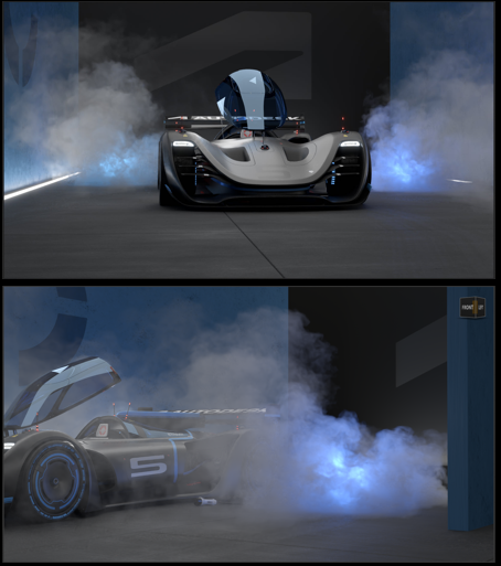

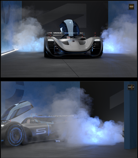

  • Ray-marching - Every ray that penetrates a volume triggers a search for both the entry and exit points.
  • Multi-scattering - (Only available for Raytracing mode) Provides a more physically accurate result than ray-marching, as it takes into account the scattering of light and color within the volume. Uses traversal optimization automatically. Every scatter event triggers a search for the new exit point, greatly enhancing the speed of multi-scattering compared to ray-marching.
Ray-marching Multi-scattering
Ray-marching rendered volumes Multi-scattering rendered volumes
However, it is more computationally intensive and requires more samples to converge to achieve a noise-free result. Therefore, it is currently only available for Raytracing.
