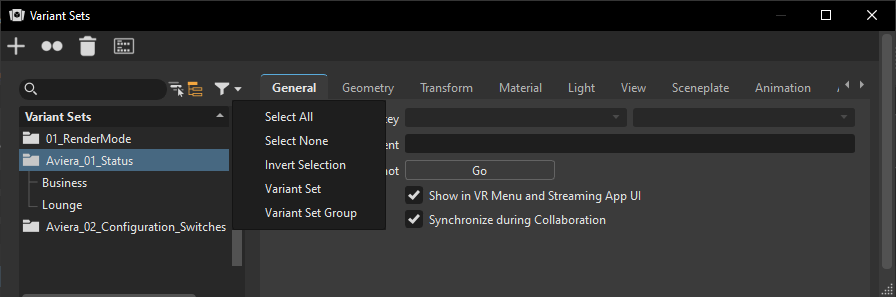

Filter and context menu Filtering Searches
Filtering is enabled when the filter changes from grey to orange. Click the arrow to the right to select one or more filters.
  1. Enter a string in the Search field.
  2. Click Filter and context menu and select one or more filters. Choose from:
    • Select All - Selects everything.
    • Select None - Deselects everything.
    • Invert Selection - Selects all the options not originally selected.
    • Variant Set - Factors all variant sets into the filtering.
    • Variant Set Group - Factors all variant set groups into the filtering.
