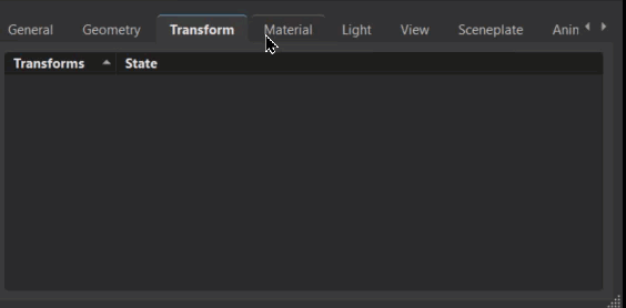

Use the tabs to the right to for specific grouped options for materials, lights, etc.
Provides the location where hotkeys for variant sets can be defined.
Creates or modifies the geometry variants. To create a geometry variant, drag a geometry node or group node to the right section in the Geometry tab.
Creates or modifies the transform variants. To add a transform variant to the variant set, drag a node with transform variants to the right section in the Transform tab. You can also drag a variant from the Transform dialog or from the Variants dialog to that section.

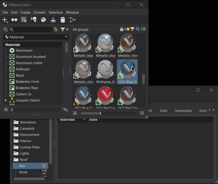

Creates or modifies the material variants. The supported types of materials variants are switch, Substance, OCS, and X-Rite materials. To create a material variant, drag a material node, such as a Substance, from the Material Editor to the right section in the Material tab.
