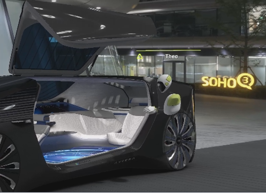

For VR users, we improved the touch behavior of the VR hands. Now it’s much easier to trigger touch sensors or the VR menu with your VR hands, which makes the VR experience more fluent and natural.
When being in a Collaboration, we added a Pause button to the Collaboration Window. This gives you the option within a Collaboration with VR users attending as well, to render out a Raytraced Antialiased image in Desktop mode.
Now you can also go into a view of a VR user, the so-called spectator view. Pause the collaboration and render out a raytraced antialiased image from out of this view. Pressing the Pause button again, will switch you back to the collaboration session, instantly.
