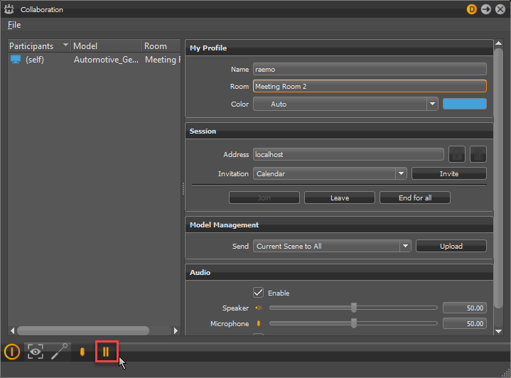

Tap the new Pause button to pause synchronization with the collaboration server and allow for an antialiased snapshot to be taken. Audio is not paused. Once restarted, all changes occurring during the pause are applied. If a session is not paused, the movement of any VR participant will interrupt antialiasing, restarting the process again.
