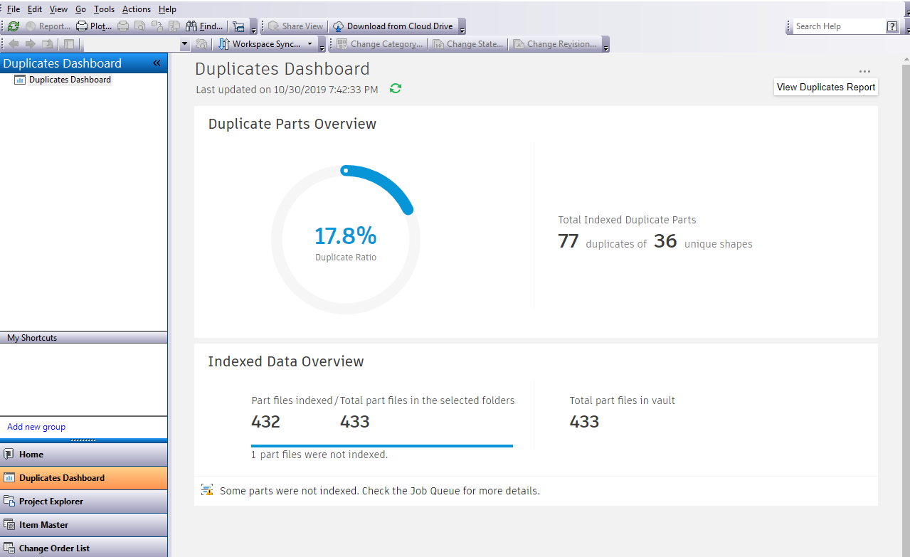

Use the dashboard to view the status of duplicate and indexed parts.
Data is available when folders you specified in the Duplicate Search Settings dialog are indexed.
View Duplicates Report | Click to display report of duplicate parts. You can export it to Excel, PDF or a Word format. |
Duplicates Overview | Displays overview of the indexed parts |
Total Indexed Duplicates | Shows number of duplicate parts of the same shape in the specified folder. |
Indexed Data Overview | Displays overview of the indexed parts. |
Part files indexed | Number of already indexed Inventor part files from the specified folder. |
Total part files to be indexed | Number of Inventor part files from the specified folders to be indexed |
Total part files in Vault | Displays total number of Inventor part files in the Vault. |
Duplicate Ratio | Represents the number of duplicate parts divided by total number part files in the specified folder. |
