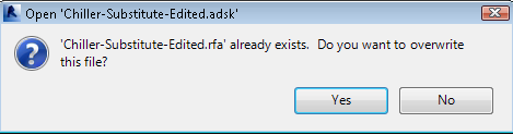

Note: If you open the same .adsk file after already having converted it to a .rfa file, you are asked if you want to overwrite the existing .rfa file.
Click Yes to overwrite any changes to the file on the local drive, or click No to cancel.
