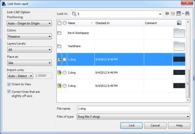

  1. Click Link from Vault on the Revit Vault Ribbon.
  2. Locate the DWG that you want to insert.
  3. Select your positioning preference from the Positioning drop-down.
  4. Select your Colors preference from the Colors drop-down.
  5. Select the position at which to place the DWG in the Place at drop-down.
  6. If needed, modify your import units.
  7. Click Link to insert the DWG.
